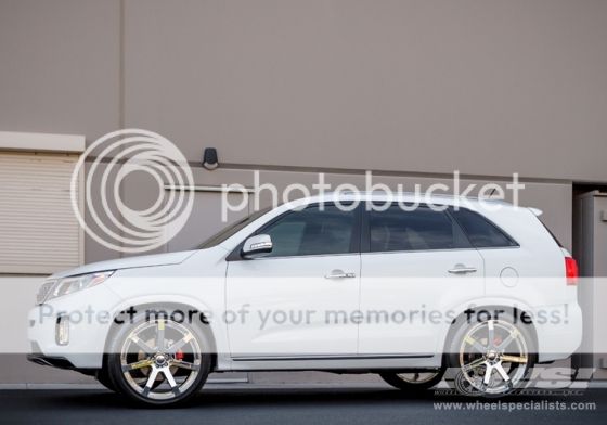

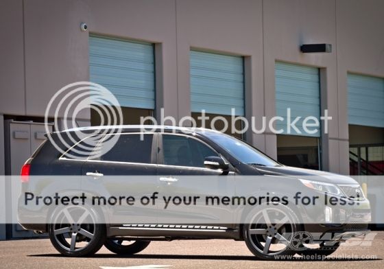

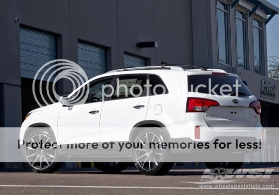

#21 · (Edited)
changing to 20's might as well do 20x8 do a 245 or 255 tire stability in cornering will improve, an dont go less than 10mm offset.. steering will be affected esp w/ uneven roads.. also, be careful in choosing, check wheel weight must not be heavy acceleration braking will be affected
cheers
(see pics prior to this post)
