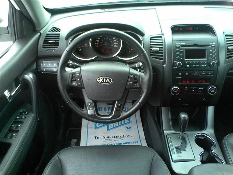

I finally got my hands on a 2011 Sorento EX V6 AWD! After owning two Nissan pathfinder LE's over the course of 8 years, It was time to get something a little more modern. I also enjoy my 2010 Hyundai Sonata SE. I was planning on joining the Kia/Hyundai family since I am very happy with the Sonata after 100,000Kms. I always liked the styling of the Sorento ever since it came out. The SantaFe may be the same underneith the sheet metal, but the Sorento wins the beauty contest IMO. Although the new Santa Fe is quite nice!
This was the final straw for the Pathfinder (No clunking or warning of a failure at all, just happened out of nowhere) Also, I am very familiar with the forum atmosphere. Been on them for all my vehicles for years now!
Literally the day this happened the search was on. I managed to find the cheapest EX V6 in the province! It was apparently a dealer demo and the boss just said to get rid of it. CarProof and CarFax are clean!
Anyways, I picked it up Thursday morning. Drove it 100K on the highway home and averaged 26MPG. Now I wasn't exactly babying the throttle either. Going from an old worn ou 3.5L V6 with 240HP NEW (200HP or less now I suppose) and a 4 Speed automatic is a HUGE difference. This thing has heaps of power. It's so hard to keep my right foot from getting me into trouble.
pre detail:
