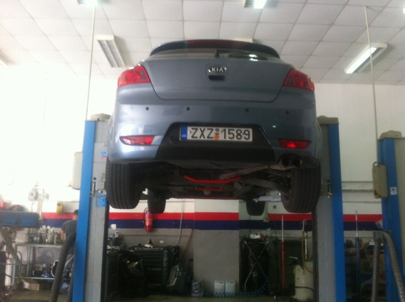

ASP_tech Reinforcement
A friend of mine is the mechanic behind the firm...He is going to release them through ebay soon i think...
The back is like this...
(the photo is old,as the lower bar was re-built with increased space from the exhaust pipe..._

Looks fantastic mate! Job well done by your mate :)
Could that lower rear bar not sit above the exhaust instead of below it? Looks like there's space up there, but maybe it wouldn't work as well or something?

I think he gave it a try,but problems occured + I liked the fact it was noticeable from behind hehehehehehe

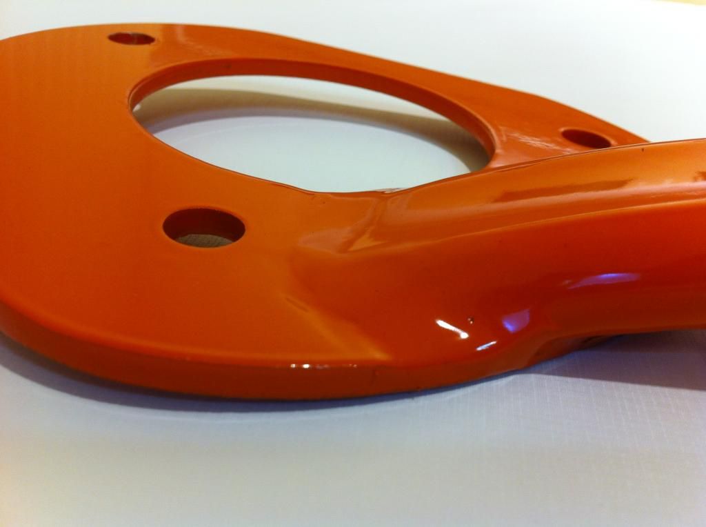

ps.They are fully made from aluminum( not the commonly used aluminum...) and not iron...
They all weight together only 2,7kg...

That's a cool cross section, like the fact they are not just round section tubes.
