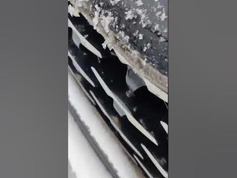

I am new to this site so i don't know if its US centric but still... I am in EU and have Kia Sportage 2021: 1,6l CRDi HP Mild Hybrid 7DCT 4WD 100kw and i suspect that there are some issues with it. One day car totally died on me and Kia dealer replace the starter. Then 2 months after that when i started up the engine it made ugly noise, RPM fluctuated up and down (on idle) and car had now power to move. Here is the video:
www.youtube.com
