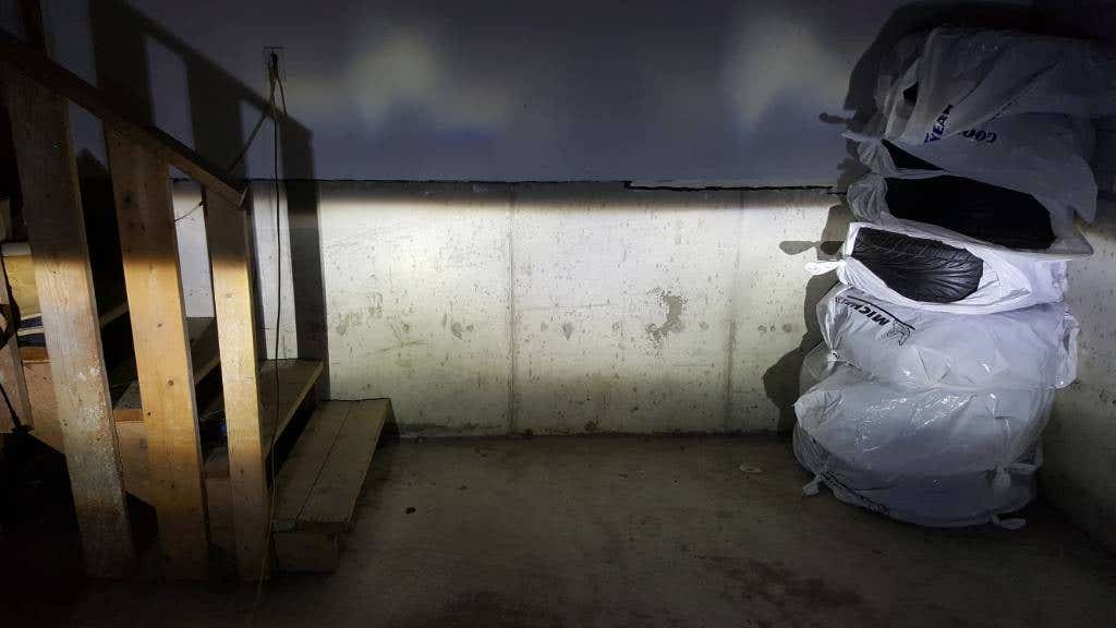

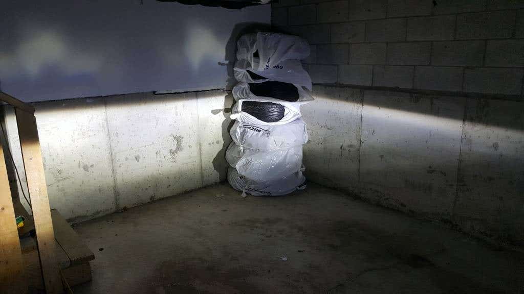

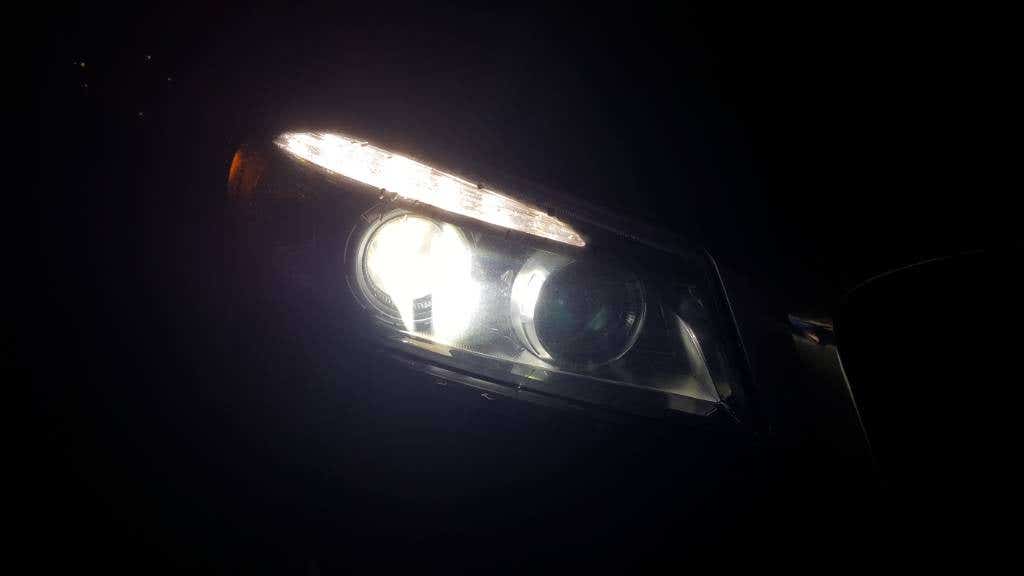

For those in Canada, I used this kit from Amazon.ca, see Attached photos. In summary, I'm amazed, much brighter and cut off is sharper, with hot spot spread out. Highly recommended!

Hi everyone, I just updated the original post with photos.
I'm blown away! Much brighter, cut off is sharper, hot spot is spread out vs halogen bulbs. I took it for a test drive and love it!
I'm a headlight projector fan, I've retro fitted/modded several vehicles and bike in the past, so I was looking for a great upgrade to these halogen projectors without breaking warranty (ie swapping projector or lenses) and am glad I found this. I hope the bulbs last at least a year haha.
Here is a photo with the passenger side LED bulb and the driver side halogen. Hard to tell in photo but it is much brighter and the cut off line is much sharp vs the halogen's fuzzy cut off.
