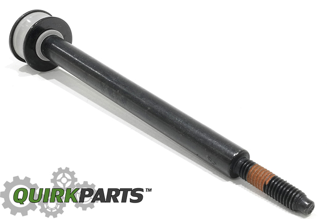

Can anyone confirm the right part number for a Lambda II Sorento SX?
I stupidly over-torqued one of the two long shaft bolts that hold the upper intake manifold to the lower intake manifold. It snapped the threads off. Once I back out the broken off bit of threads I'm going to need to replace the bolt that broke. I cannot find it on the diagrams on kiapartsnow or anywhere else. I ended up finding a bolt that looks very similar (29213-3C010) but I have no idea if this is the right one or not.
This is the picture of the PN that I found, and it looks almost exactly like the bolt in question, complete with washers and rubber bits. Hoping someone has the info I need to confirm this is right (dealership or have had to replace this before).

Way late reply to my own post, but the part number is 29213-3C000 for anyone needing this. Costs about $20.
