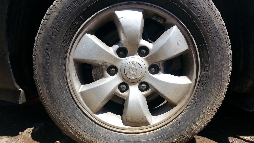

I picked these wheels up for a great price so thought I'd do a restoration on them. I used my neighbor's sand blaster to take the wheels down to the original clear coat. Previous owners had done several very poor quality paint jobs on them with, I'd guess, BBQ paint and some black paint that was more like road tar (still soft). I washed, degreased, sanded the rims and primed them. Then set to work filling all the dings and deep scratches with Bondo and spot putty. Sanded again, then a couple coats of sand-able primer. A few more touch-ups with spot putty and another couple coats of primer and wetsanding. Then I applied 3 coats of Duplicolor Perfect Match Bright Silver Metallic, wetsanding between coats. I am awaiting my SprayMax 2K catalyzed clear coat. That should give them a very glossy appearance and protect them as well as the original factory clear coat.
I ordered 4 used Kia center caps for $20.00 from Ebay. They appear to be in excellent shape.
Before:
[/URL]
After:
