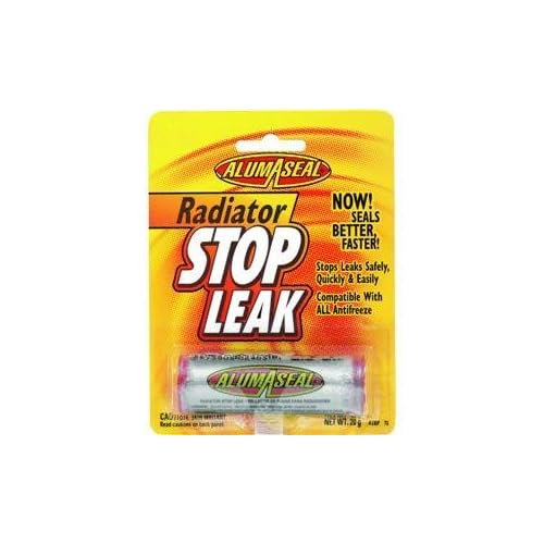

On my old 97 Nissan, I had a similar leak. A new rad (aftermarket) was north of 700++. I went into my local shop and bought this tube of 'stop leak' and poured some in (can't remember if it was half or full tube) and I kid you not - the leak stopped!
This was a temporary fix that lasted about two years! Eventually the crack that joined the rad to the inlet pipe grew too big for the stop leak power to work. If anything, it bought me time to figure out a better deal or part source the rad.
No harm experience in using the magic powder.

Why don't you simply locate the leak, and fix it? Although stop-leak might temporarily fix your issue, it doesn't permanently solve anything. It also coats the internals of the cooling system (including radiator tube surfaces) and reduces the exchange of heat that should be happening. Often , the addition of goop to stop small leaks ends up creating a bigger problem with the cooling. Smaller systems are especially vulnerable. If you feel you MUST try some, please start with a "partial dose", and not the whole container the first time around. Bars Leak has worked for me in the past, but use sparingly!

Most rad leaks are not worth repairing IF they really are 'repairable'. I had no issues using the powder and it works. The logic of ruining your cooling system is offset by the fact the rad is already going south. The high cost alone is worth trying this first.

Using stop leak will more than likely stop the leak.
It will more than likely plug the heater core.
